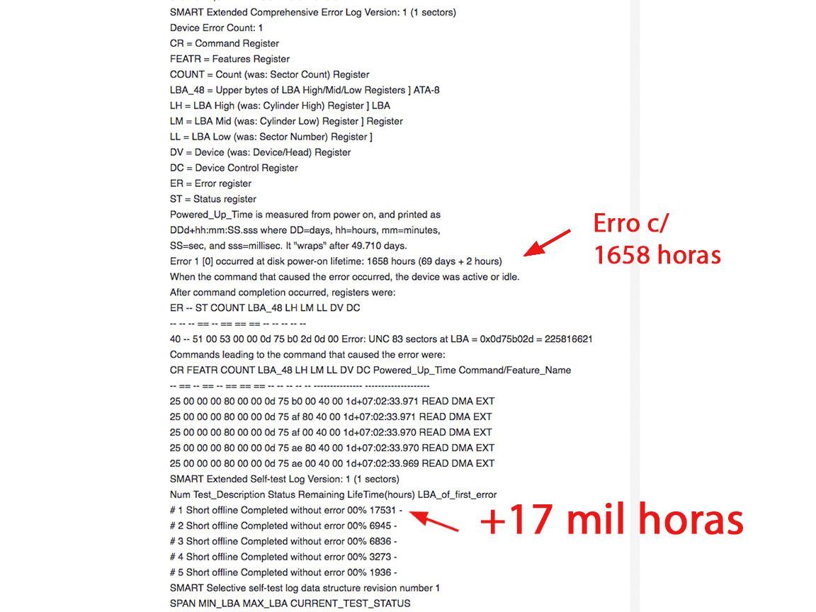

Lí no segundo tópico que compartilhei do adrenaline (acima) que o programa HDDguardian, citado pelo usuário "Shot-Gun" seria o mais adequado para checar a saúde do HD pois ele detecta se o HD teve algum dado antigo apagado, pois muitas vezes não acusa as horas desse dado apagado no Crystal Disk, só nesse HDDguardian.
Seguem informações coletadas pelo software HDDguardian, alguém saberia analisá-las:

Error 1 [0] occurred at disk power-on lifetime: 1658 hours (69 days + 2 hours)
When the command that caused the error occurred, the device was active or idle.
After command completion occurred, registers were:
ER -- ST COUNT LBA_48 LH LM LL DV DC
40 -- 51 00 53 00 00 0d 75 b0 2d 0d 00 Error: UNC 83 sectors at LBA = 0x0d75b02d = 225816621
Commands leading to the command that caused the error were:
CR FEATR COUNT LBA_48 LH LM LL DV DC Powered_Up_Time Command/Feature_Name
25 00 00 00 80 00 00 0d 75 b0 00 40 00 1d+07:02:33.971 READ DMA EXT
25 00 00 00 80 00 00 0d 75 af 80 40 00 1d+07:02:33.971 READ DMA EXT
25 00 00 00 80 00 00 0d 75 af 00 40 00 1d+07:02:33.970 READ DMA EXT
25 00 00 00 80 00 00 0d 75 ae 80 40 00 1d+07:02:33.970 READ DMA EXT
25 00 00 00 80 00 00 0d 75 ae 00 40 00 1d+07:02:33.969 READ DMA EXT
SMART Extended Self-test Log Version: 1 (1 sectors)
Num Test_Description Status Remaining LifeTime(hours) LBA_of_first_error
# 1 Short offline Completed without error 00% 17531 -
# 2 Short offline Completed without error 00% 6945 -
# 3 Short offline Completed without error 00% 6836 -
# 4 Short offline Completed without error 00% 3273 -
# 5 Short offline Completed without error 00% 1936 -
SMART Selective self-test log data structure revision number 1
SPAN MIN_LBA MAX_LBA CURRENT_TEST_STATUS
1 0 0 Not_testing
2 0 0 Not_testing
3 0 0 Not_testing
4 0 0 Not_testing
5 0 0 Not_testing

@FerGazz Ok. Posso estar enganada, mas o SMART tem o registro de um erro ocorrido após 1658 horas de uso (69 days + 2 hours). Portanto se você não tem esse HD há tanto tempo acertou, é refurbished.
Já tem mais do que base para pedir troca ou dinheiro de volta.

Vish, não sei como fazer essas TAGs aí, vou inserir um print da tela no local que informa o tempo de uso, descobri onde é... além desse erro que você relatou parece que esses dados mostram, no mínimo, 17 mil horas de uso:
"1 Short offline Completed without error 00% 17531"
Bate com os relatos do pessoal do Adrenaline, um deu 20 mil horas, no outro 22 mil horas
