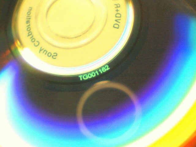

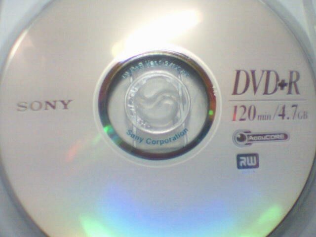

Gostaria de saber se esta mídia Sony DVD+R é falsificada?
Unique Disc Identifier : [DVD+R:YUDEN000-T02-000]
Disc & Book Type : [DVD+R] - [DVD+R]
Manufacturer Name : [Taiyo Yuden Co. Ltd.]
Manufacturer ID : [YUDEN000]
Media Type ID : [T02]
Product Revision : [Not Specified]
Blank Disc Capacity : [Not Supported By Method 2]
Recording Speeds : [1x-2.4x , 4x , 6x-8x]
[Method 2 Might Not Always Detect All Speeds]
[ DVD Identifier V4.3.0 - http://DVD.Identifier.CDfreaks.com ]

Código impresso no CD - TG001162
