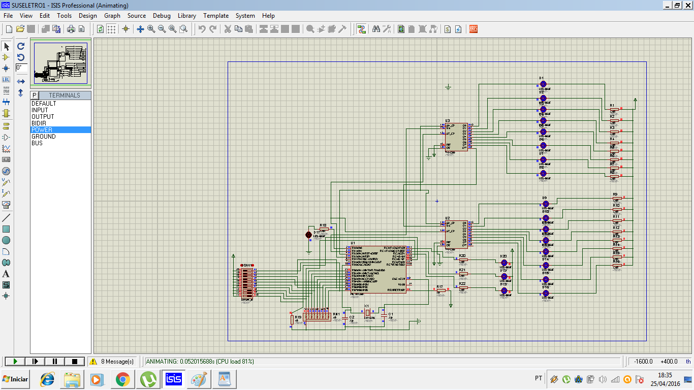

GetData
  movf   LOW(CHANNEL01),w      ; PWM 1
    addwf   FSR0L,F
    movf   HIGH(CHANNEL01),w
    addwfc  FSR0H,F
    movff   INDF0,CCPR1L
    lfsr    0,RxBuffer
    movf   LOW(CHANNEL02),w  ;PWM 2
    addwf   FSR0L,F
    movf   HIGH(CHANNEL02),w
    addwfc  FSR0H,F
    movff   INDF0,CCPR2L
     lfsr    0,RxBuffer
    movf   LOW(CHANNEL03),w   ;PWM 3
    addwf   FSR0L,F
    movf   HIGH(CHANNEL03),w
    addwfc  FSR0H,F
    movff   INDF0,PWM03
    lfsr    0,RxBuffe
    ;xxxxxxxxxxxxxxxxxxxxxxxxxxxxxxxxxxxxxxxx
PWMs
    clrf    PWM00
    movff    TMR0L,TEMPO
    movf    TEMPO,W
    CPFSEQ    PWM00,W
    bra        OKGO
    return
OKGO
;---------------------- porta de saida-------------------
    clrf    LEDA
    movf    TEMPO,W
    CPFSLT    PWM03,0
    bsf        LEDA,0
    movf    LEDA,W
    CPFSEQ    LATA,W
    movff    LEDA,LATA
; ;como colocar essa saída(Lata) em um bit do registrador 74hc595
