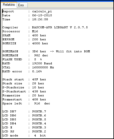

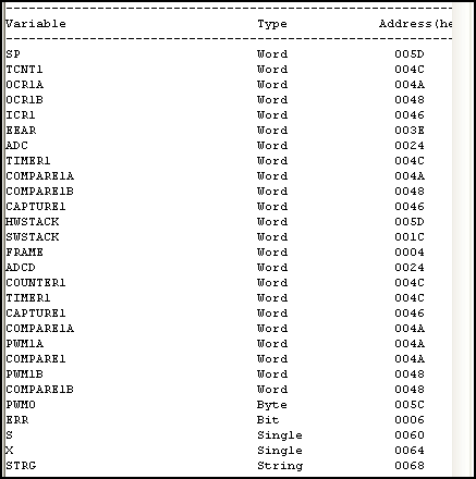

'RX-TX by xyko'------------------------------------------------$regfile = "m328pdef.dat"$crystal = 16000000$baud = 19200Config Com1 = Dummy , Synchrone = 0 , Parity = None , _Stopbits = 2 , Databits = 8 , Clockpol = 0Dim Tecla_recebida As Byte                                                      'estou usando byte porque é                                                                                'apenas para retornarEspera:'Do  Do : Loop Until Ucsr0a.rxc0 = 1                                               'espera um caractere na COM1  Tecla_recebida = Udr0                                                         'pega o dado referente a tecla  Print "O caractere recebido foi [ " ; Tecla_recebida ; " ]" 'loopGoto EsperaEnd

Bom fiz isso no keyl prum atmega16 só pra teste.
//cristal 3.6864MHz#define F_CPU 3686400#define BAUD 2400                                  // define baud#define BAUDRATE ((F_CPU)/(BAUD*16UL)-1)            // set baud rate value for UBRR #include <ioavr.h>/* UART Control and Status Register A */#define    RXC      7#define    TXC      6#define    UDRE     5#define    FE       4#define    DOR      3#define    PE       2#define    U2X      1#define    MPCM     0 /* UART Control and Status Register B */#define    RXCIE    7#define    TXCIE    6#define    UDRIE    5#define    RXEN     4#define    TXEN     3#define    UCSZ2    2#define    RXB8     1#define    TXB8     0//************macros pra escrita de constantes em forma de bits caso o compilador não tenha*********/#define B8__(x) ((x&0x0000000fLU)?1:0) \+((x&0x000000f0LU)?2:0) \+((x&0x00000f00LU)?4:0) \+((x&0x0000f000LU)?8:0) \+((x&0x000f0000LU)?16:0) \+((x&0x00f00000LU)?32:0) \+((x&0x0f000000LU)?64:0) \+((x&0xf0000000LU)?128:0)#define HEX__(n) 0x##n##LU#define b8(d) ((unsigned char)B8__(HEX__(d)))/* for upto 16-bit binary constants, MSB first */#define b16(dmsb,dlsb) (((unsigned short)b8(dmsb)<< \+ b8(dlsb))/* for upto 32-bit binary constants, MSB first */#define b32(dmsb,db2,db3,dlsb) (((unsigned long)b8(dmsb)<<24) \+ ((unsigned long)b8(db2)<<16) \+ ((unsigned long)b8(db3)<< \+ b8(dlsb))//unsigned char USART_Receive( void )//{///* Wait for data to be received *///while ( !(UCSRA & (1<<RXC)) && kb3 );///* Get and return received data from buffer *///return UDR;//}void USART_Transmit( unsigned char data ){/* Wait for empty transmit buffer */while ( !( UCSRA & (1<<UDRE))) ;/* Copy 9th bit to TXB8 */UCSRB &= ~(1<<TXB8);//if ( data & 0x0100 )//UCSRB |= (1<<TXB8);/* Put data into buffer, sends the data */UDR = data;}void uart_init (void){    UBRRH = (BAUDRATE>>8);                      // shift the register right by 8 bits    UBRRL = BAUDRATE;                           // set baud rate    UCSRA=0x20;    UCSRB|= (1<<TXEN)|(1<<RXEN);                // enable receiver and transmitter//    UCSRC = b8(10000110);    UCSRC=b8(10001110);//acesso, assincrono, sem paridade, 2 stop bits, 8 bits, polaridade fall    //UCSRC|= (1<<URSEL)|(1<<UCSZ0)|(1<<UCSZ1);   // 8bit data format}void printf(const char *s){while(*s) USART_Transmit(*s++);}struct fl4        //estrutura do float em 4 bytes{unsigned char flb0;unsigned char flb1;unsigned char flb2;unsigned char flb3;};union  {struct fl4 byte_float;  //4 bytes contidos em...float _float;      //32 bits} cf; //char mesclado com float#define pi cf._float      //pi no float#define f0 cf.byte_float.flb0    //byte 0 de pi#define f1 cf.byte_float.flb1    //byte 1#define f2 cf.byte_float.flb2    //byte 2#define f3 cf.byte_float.flb3    //byte 3void main(void){float i;uart_init();printf("Computando valor de pi...");for(i=1; i<=2700; i+=2){pi += 4/i;i += 2;pi -= 4/i;}printf("4 bytes asc-ii do pi:");USART_Transmit(f0+'0');USART_Transmit(f1+'0');USART_Transmit(f2+'0');USART_Transmit(f3+'0');for(;;}

Não se assuste com as macros. O keyl não permite usar o tradicional 0b10101010 por isso a macro b8(10101010)
A proposta é simples
-não usar libs prontas (note o printf minimalista)
-calcular o valor de pi e armazenar num float 32 bits
-enviar os 4 bytes do float para a serial no formato asc-ii.

@Isadora Ferraz.
As 81 linhas com 16 bytes cada  do seu código HEX deu 1296bytes.
Não sei o que quis dizer com imprimir em ascii. Eu imprimi como string, que é o ASCII já representado como caracteres.
O report do bascom , fonte e endereços das variáveis caso precise misturar com ASM.
Este código deu 982 bytes.
'Calculo do PI$regfile = "m16def.dat"'$NOINIT -  se não quiser inicialização automática.$crystal = 16000000                                                             ' used crystal frequency$baud = 19200Config Com1 = Dummy , Synchrone = 0 , Parity = None , _Stopbits = 1 , Databits = 8 , Clockpol = 0Dim S As Single , X As Single , Strg As String * 10S = Atn(1) * 4                                                                  'arcotangente de 1*4=PIStrg = Str(s)Print Strg                                                                      '3.141593End
